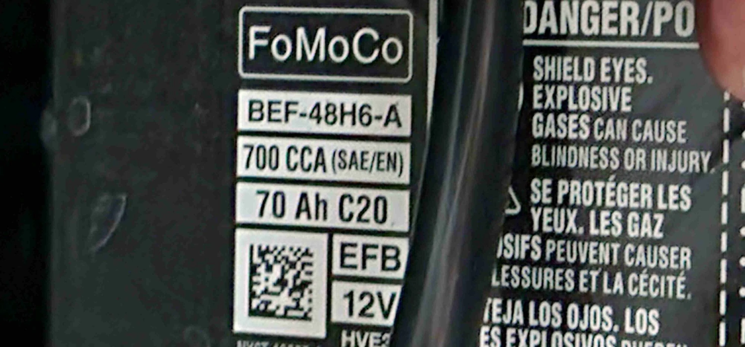

Whenever I see battery posts I like to give my opinion about these "computers on wheels " we drive. First thing though, if yours is a 2023. I'm pretty sure it came from the factory with an AGM battery. My first AGM battery (Odyssey Extreme) lasted 7 years of daily driving. I finally killed it myself due to buying a Jeep and not driving the Silverado much. As far as I am concerned Odyssey Extreme is the best battery you can buy.
As for my 2023 BS Badlands, it's only 4 months old so it is bone stock and the owner's manual says it has an AGM installed. I believe them but should probably verify. I am also very meticulous about keeping "engine off" usage to a minimum. BEFORE I shut the engine off I disconnect my dash cam, turn off the AC, turn off the radio, and roll up all windows. I always disable the Auto Stop/Start feature. My thinking is anything that is running with the engine off is discharging the battery.

First of all, I know you are laughing thinking" I'll get him to go to his vehicle and check" . Laugh away because of course I did. And you are correct. hahaha My badlands apparently has an Enhanced Flooded Battery, not Advanced, but Enhanced. Although some BS do come with AGM batteries. Me being me I just learned this today but I'm glad I did. According to what I read Enhanced Flooded Batteries are manufactured to different standards than flooded cell batteries or Advanced Flooded Batteries.I also read an AGM battery can be used as an upgrade but the battery management system must be configured to allow it to function properly. Holt shit what a rabbit hole that was. :crackup: :crackup: :crackup: :crackup:

@rocks Bronco Sports shipped from the factory with one of these or other batteries:
Examples: (not a complete list)
BEF-48H6-A,
BEF-48H6,
BHEF-48H6
Lead-Acid
EFB: Enhanced Flooded Battery
BAGM-48H6-760 (AGM)
AGM: Absorbent Glass Mat
Those are just the part numbers. We all don’t know how many different battery manufacturers Ford used to-date for bronco sport batteries especially under supply chain constraints.

I have BEF-48H6-A. No "H" in front of the "E".

After my extremely positive experience with the Odyssey Extreme battery I would tend to agree. But at least I got an EFB with mine so a slight upgrade from a standard flooded cell battery. I'll be selling mine before the warranty expires anyway so no biggie.And I always have my backup a red JNC77OR
I should have just said “Examples” as in the following since I have no idea how many battery part numbers Ford has used for the Bronco Sport:
BEF-48H6-A,
BEF-48H6,
BHEF-48H6
Lead-Acid
BAGM-48H6-760 (AGM)
And perhaps the variety of part numbers relates in some way to battery problems bronco sport owners has reported both with the EFB and maybe to a lesser extent the AGM battery. 🤷‍♂️
