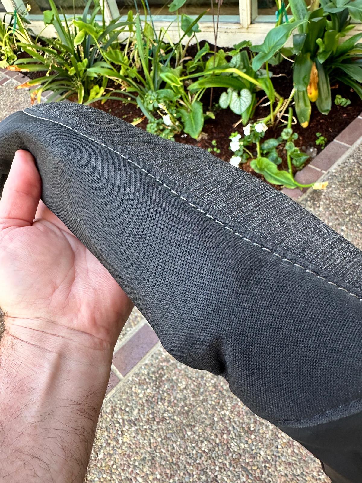

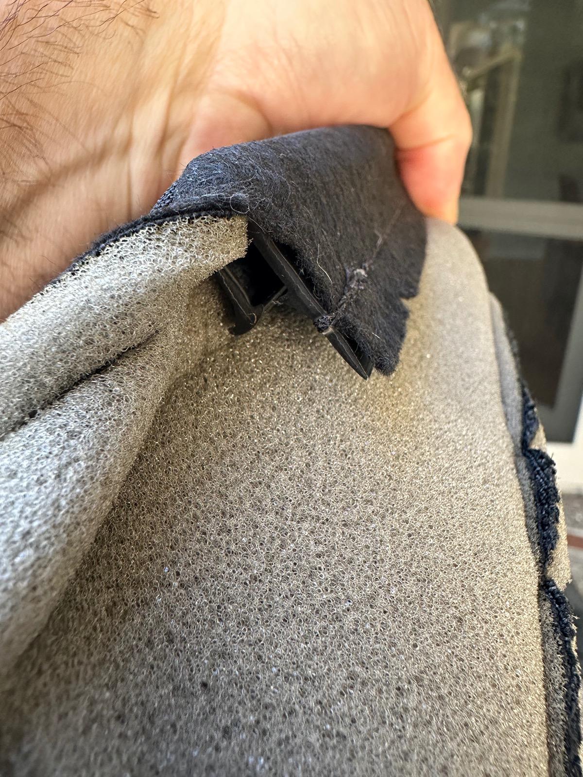

I just replaced my driver's seat lower cushion yesterday - so this is fresh in my mind. Fold the front edge so that the plastic clip opening is facing up. Press this against the front edge of the seat pan sheet metal to clip it on.
Ford Bronco Sport Front Drivers Seat Cover IMG_6581
Here is a side view showing the plastic latch facing up (so it should face up when attached but is facing down in this picture because of the way I'm holding it)
Ford Bronco Sport Front Drivers Seat Cover IMG_6582
Here it the front edge of the seat folded

Thanks much Elav, following your guidance was easy to put back. Good as new. 😂
