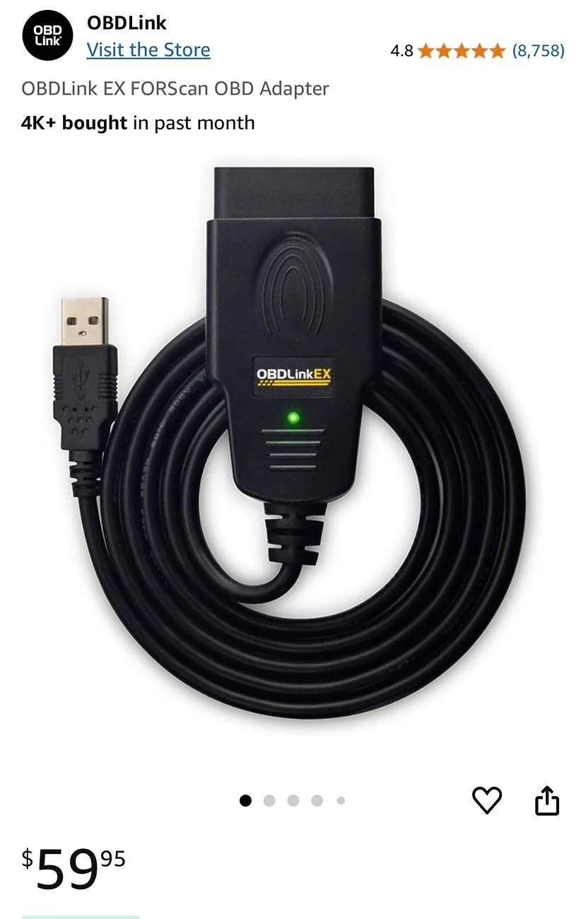

Thanks for the input. I have a tower PC. Is there such a thing as a 50' long cord to stretch to your driveway? Or will some cheap $40 laptop work like Dell chromebook or HP chrome book? What OBD plug-in do I need? Or is there 1 plug-in you can get that acts as the laptop too?
